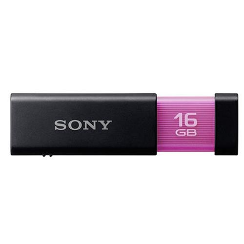

| SONY 16GB MICRO VAULT CLICK
| Not Tested
| Not Tested
| Works
| Works great in first Wii USB slot, formatted to WFSB in WBFS Manager 3.0.
