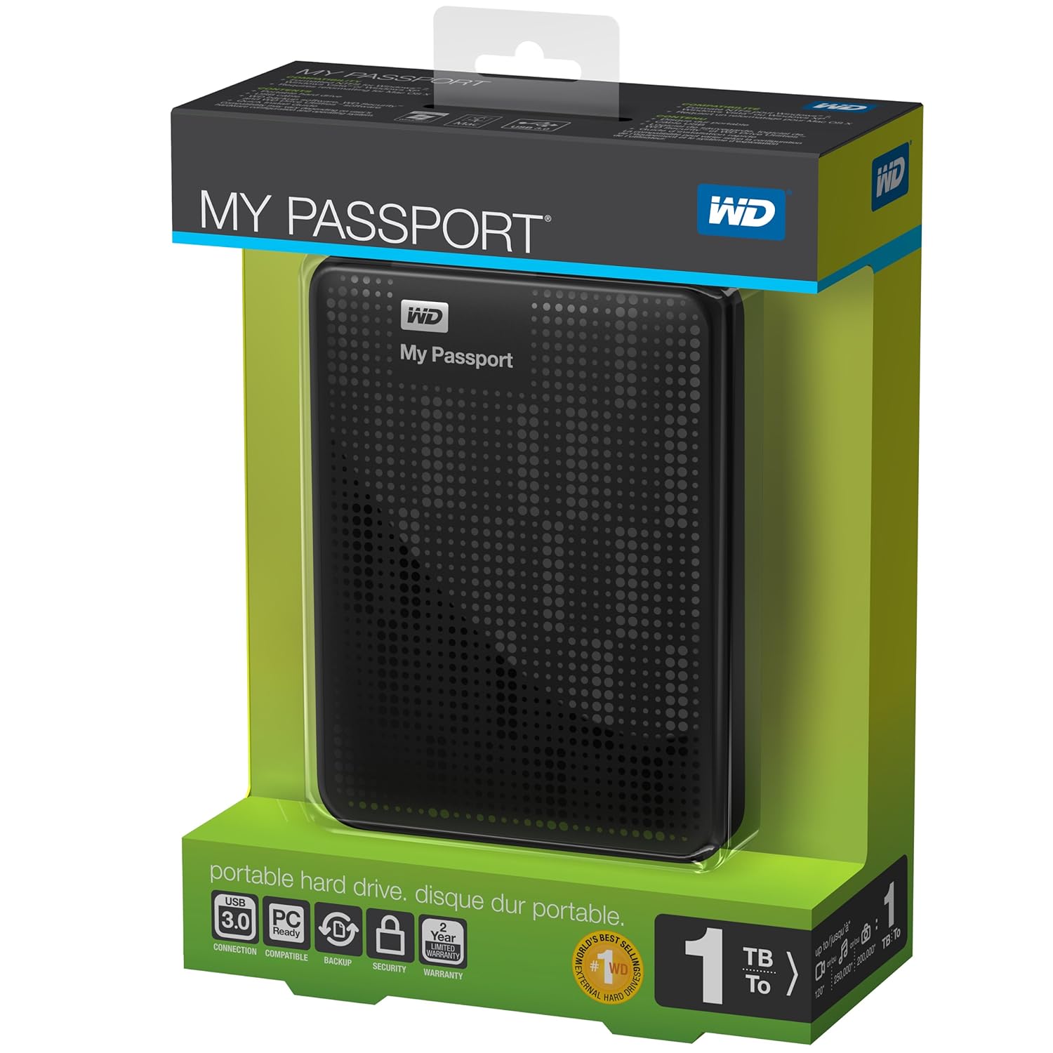

| WD My Passport 1 TB USB 3.0 (WDBBEP0010BBK (BL or RD are blue or red))] | 1058:0748 | Not Tested | Not Tested | Works | Formatted with 10GB FAT32 partition and 990GB NTFS partition for Wii games/PC backups etc. Used Configurable USB Loader and WiiFlow. Worked instantly. Does not require external power supply. Best choice. Works Very Good In WFBS partition 600GB and the rest in NTFS whit WiiFlow and USB Loader GX. Worked like a charm.
HDD factory settings are no spindown - used WD program at top of article to verify. Set up first partition FAT32(64kb cluster) 80GB, second partition NTFS. WiiFlow 4.2 as loader of choice - emunand(for Wii/VC) and Gamecube(using Nintendont) on FAT32, Wii(installed to WBFS using WiiBackupManager) on NTFS partition. |
3 |
| WD My Passport | 1058:0748 | Not Tested | Not Tested | Works | Two partitions: 10G on fat32 for Data and 922G on fat32 for the games as wbfs copied by Wiithon. It is working fine so far. | 0 |
